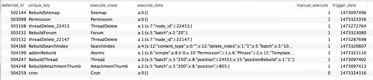

Can you look at your xf_deferred table in the database and see what entries are there? I suspect this error may have already happened in a previous rebuild and that has gotten stuck. You'll likely need to remove the entry, though it appears there's a corrupt image on the system (which was previously valid, I expect).
It'll be the AttachmentThumb job that's causing this. You'll need to remove that entry. There are 2 thread deletion jobs in there (based on node IDs). I assume you deleted some nodes so that's expected.
Once that row is deleted, you should have a "there are stopped manual rebuild processes" message in the main control panel page -- click that to run them and it should work through the jobs.

Is there any way to tell, identify or find which image it might be with the batch 200, position 805 in the deferred thread?
It'll be one of the next 200 xf_attachment_data records from ID 805 and up. You might be able to identify it specifically if you drop the batch size down. You'd likely then need to look in the xf_attachment table to see the content it's associated with.
