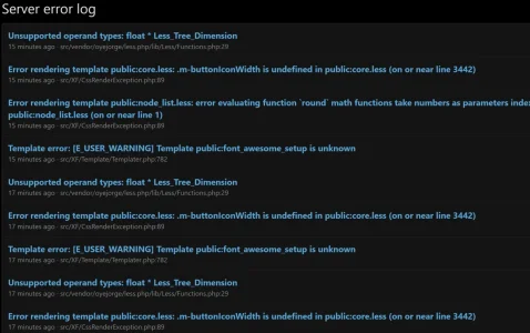

In server error log not much going on:
More will jobs will build and never run.. not sure where to go from here.. possible bug

Those three jobs are intentionally permanent. They will not be run until after the trigger_date, and when they are their last_run_date will be updated accordingly. Are other jobs failing to run? The server errors just point to a style that has not been updated for 2.3.
