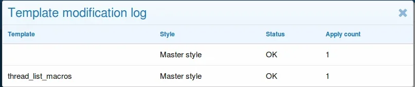

I have a template modification that showing that it's been successfully applied to two templates, but only one has a name:
Any ideas what would cause this? It should in reality only be applied to one template.

But, I made a mistake on one of them and edited it. After editing, one of the other modifications for the same 'thread_list_macros' template, for the same add-on, changed to show 2 modifications like my original post. I had to delete it a second time and re-enter it to get the correct apply count.

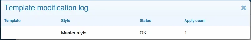

I just checked the database and the template modifications are showing as being applied to non-existent templates.

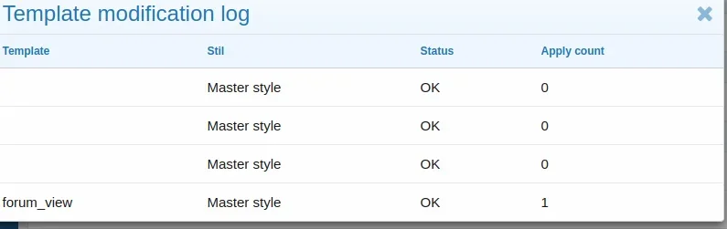

Just wanted to let you know that something similar happened to me today, still on RC1 and updated from 1.5, so it could aldready be solved.
