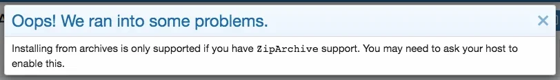

I have tried that I get an error. But my servers do have zip archive support I have already added and installed odd on.
OK I had set it on PHP Pear Packages but forgot to check it in the PHP Select Version. It installed and works!

Then you have to install add-ons in the old fashion way.
After unpacking you have to upload to your server the file s9E with al its contents to src - addons
After that in ACP/add-ons will show that there is something to install.
Once I enabled ZIP in my PHP XenForo then allowed me to search for the s9E.zip file I downloaded, I then selected it and installed it...easy as that.
