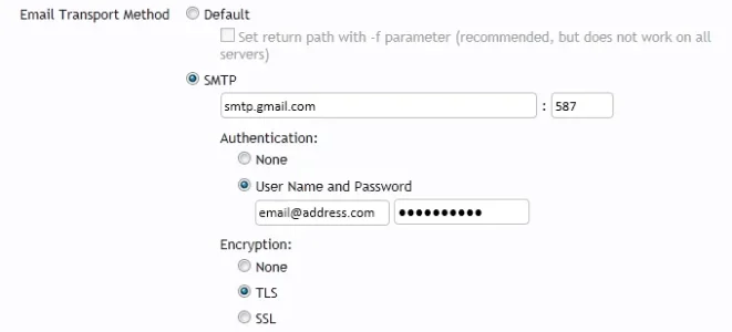

If you are using Google Apps for SMTP, you need to set the authentication (username & password) and the port for TLS to 587.
Did you set the TLS with the specific port required by Google Apps as well?
(Attached image is a working configuration of XenForo and Google Apps SMTP services.)

  • SMTP
      • Host: smtp.google.com : port: 587
      • Authentication:
      • Encryption:
        • None
        • TLS - I selected this.
        • SSL
