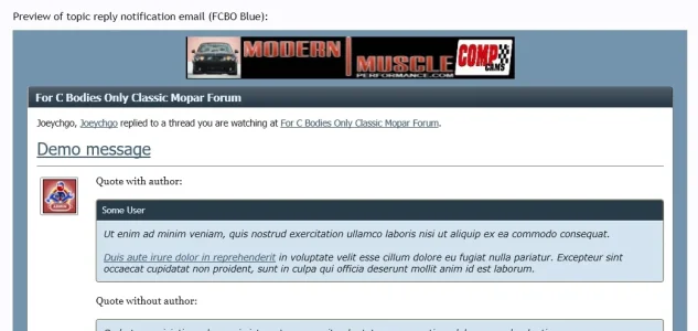

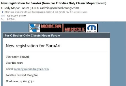

Add an option for an image w link at the bottom like you have the logo on top.
Here is what I used the logo for: --- a banner ad, which I can now sell.
You can add one already.
In editor navigate to: building blocks -> wrapper table closing.
After </table> add your code, something like this:
<table cellpadding="0" cellspacing="0" border="0" valign="top">
<tr>
<td align="center" valign="top">
   code for your footer banner
</td>
</tr>
</table>
Why table instead of using div or simply putting ad? Because some mail clients are ancient, I'm talking pre-IE6 kind of ancient. Unless content is wrapped in table there could be very unexpected results.
One thing I noticed, the logo set to center doesn't center over the email box properly
In editor navigate to building blocks -> content table opening. Add width="100%" to table tag.
