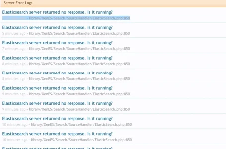

I was offered a fix as you have not you.
Elasticsearch server returned no response. Is it running?4 minutes ago - library/XenES/Search/SourceHandler/ElasticSearch.php:850
someone help me with
Thanks you.
