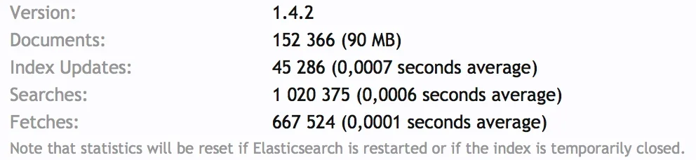

Always the same on mine:
Version: 1.4.2
Documents: 764,389 (231.7 MB)
Index Updates: 37,015 (0.0012 seconds average)
Searches: 1,346,783 (0.0039 seconds average)
Fetches: 1,346,783 (0.0001 seconds average)
