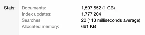

I do have a question about the amount of allocated memory.
It shows that the Documents size is 1 GB, but the allocated memory is 661KB. I thought it stores all the docs in RAM ready for instant retrieval? Or have I read those figures wrong?

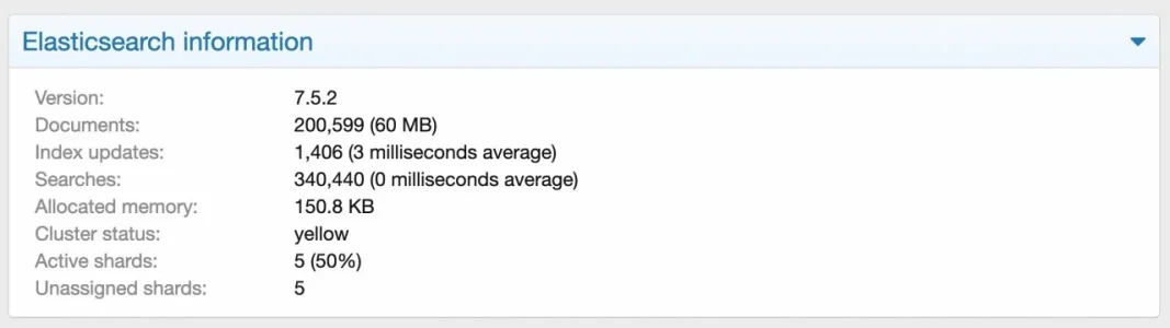

I have this element in my admin control panel that provides helpful information.

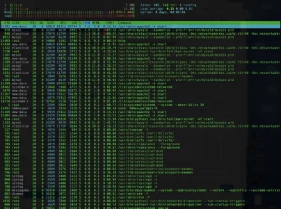

If you do a top or htop command in your Linux console, you should also be able to see the Java and Elasticsearch processes actively running.
