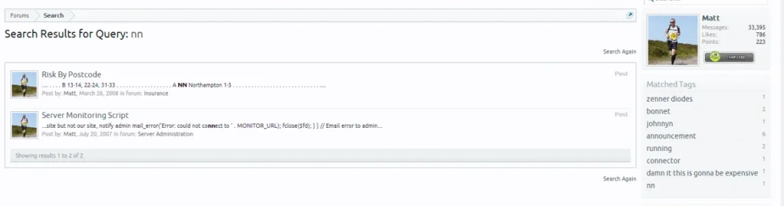

I've just tested on my site, using the tag "nn"
Search finds the nn tag (side bar for tags matched)

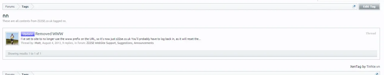

Clicking on the tag finds the thread which is tagged.

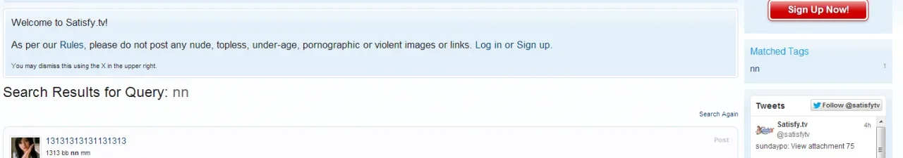

Your site finds the tag, but doesn't link to the thread
Yes, I'm using XenTag. The matched tags block was introduced in one of the recent updates to the add-on. You can see it on your site.

Sure, I'll take a look for you. Although, look at the screen shot I posted of your site above, you can see the tags block there.
Thank you again. I have seen the Matched Tags block now, its on the search results page, I thought it was on the main forums page.
