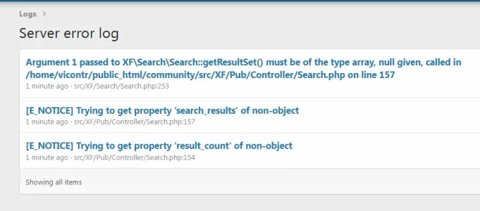

OK, so after applying the patch I removed the fix's code, and cleared all the server errors.
But new errors are showing, and the file (search.php) still draws an error even if I removed the code.
What could I have done wrong? Here's the code around line 149:

        $this->assertValidPage($page, $perPage, $search->result_count, 'search', $search);
Is there a bad space somewhere? I should have kept a copy of the original, dang it...
Help?
Andre

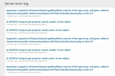

Hmmm... anyone applied the patch?
I am still getting errors. I thought it was my doing, but I'm not so sure. Anyone? I am re-applying the server errors fix for now.

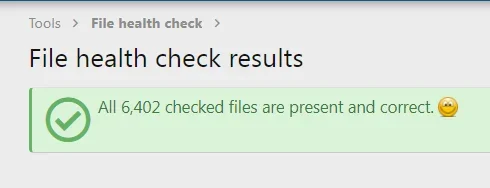

Applied their update (I left the workaround fix in Search.php there before updating). It still listed 1 file with unexpected contents initially, so I had it re-check, and that cleared the unexpected contents warning. No more errors so far, almost 2 hours later.

EDIT: I downloaded the patch manually and used the "search.php" file in it and overwrote the old one via FTP.
Then I re-ran the health check and it worked! :) So far so good!

No, no. Their update replaced the file entirely. If you saved changes to the file after that, you overwrote the file with your version. Like Brogan said on the last page, there was no need to try to remove the workaround.
EDIT:
Even if there had been a reason to remove the workaround fix, you would absolutely want to do that BEFORE running the official update, NOT after. But again, there was no need.
Oh I didn't catch that part. So basically by uploading the new Search file manually, it cleared my mistake. Thanks!
