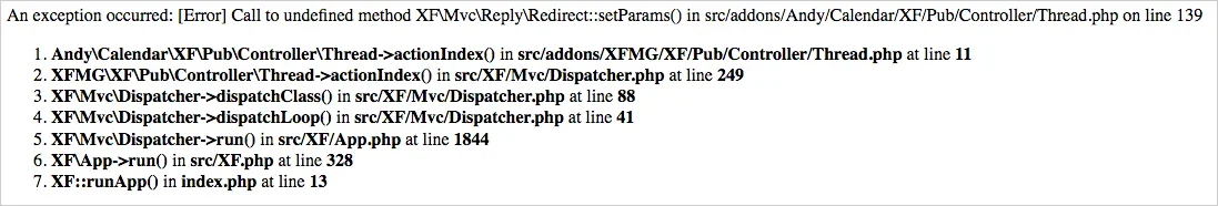

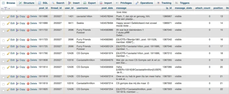

If there's a duplicate position (see position 21) in the xf_post table like this:
and in the thread_view there's a page number showing which doesn't actually exist, if that page number is clicked my add-on shows an error.
I was hoping the redirect portion of the PHP code would prevent the error but it does not.

This is the error message:
Line #139
How can I prevent this error message?
Thank you.
The error message suggests this is a problem with your extension of the code. Notably, you're trying to set view params on a Redirect reply rather than a View reply.

So what should I use in XF2?
In XF2, the equivalent to the View "ControllerResponse" is the View "Reply".
PHP:
        // return parent action if this is a redirect or other non View response
        if (!$parent instanceof \XF\Mvc\Reply\View)
            return $parent;
Thank you, Chris.

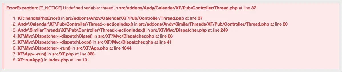

The thread should already be available in the parent with $parent->getParam('thread');
If I try that code I get the following error.
Are you using anything from the thread table other than thread_id? Surely would be easier if whatever you're loading used a relation to the thread so you could just do $thread->Data
I get the same error as pointed out in the previous post Undefined variable.
Then evidently it's not in the parent for some reason.
If it were there, then this would display something.
$parent = parent::actionIndex($params);
print_r($parent->getParam('thread'));
die();
That error is certainly not caused by $parent->getParam('thread'). It's caused by using a variable called $thread which is not defined.
$thread will of course have to be defined first, and Data was just an example, you'll have to create the actual relation before that'll work as well
