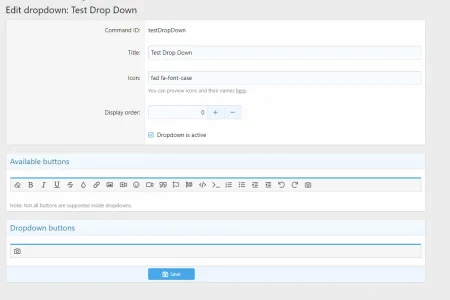

If you add a drop-down menu in the bb code editor and assign bbcodes there, assign viewing rights. And if the user does not have rights for these bb codes, then the drop-down button will still hang. It would be correct if the list for the user is empty, then do not display this drop-down menu in the editor.

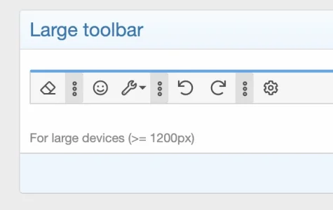

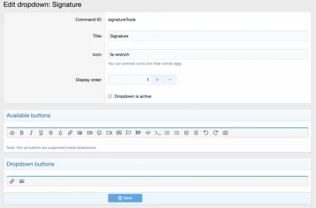

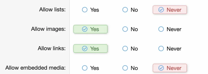

My attempted reproduction case was to set all permissions to never except "Allow images" and "Allow links".
I then modified the editor button configuration so that "Insert image" and "Insert link" were in a drop down, and I included only that drop down in the editor.

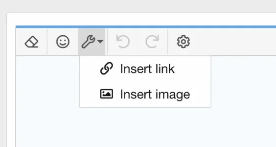

With the permissions as configured above:
With the permissions denying access to links and images:
It seems as though we correctly remove a dropdown that is empty.
So with that in mind, you need to adjust your code so the same thing happens.

1) Create dropdown

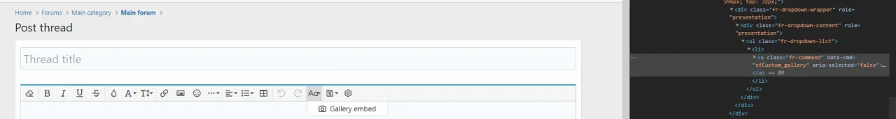

2) check event listener on gallery:
PHP:
public static function templaterTemplatePreRenderPublicEditor(\XF\Template\Templater $templater, &$type, &$template, array &$params)
        if (isset($params['customIcons']['gallery']))
            if (!self::visitor()->canViewMedia())
                unset($params['customIcons']['gallery']);

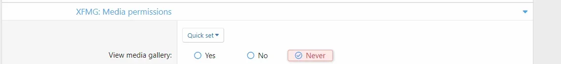

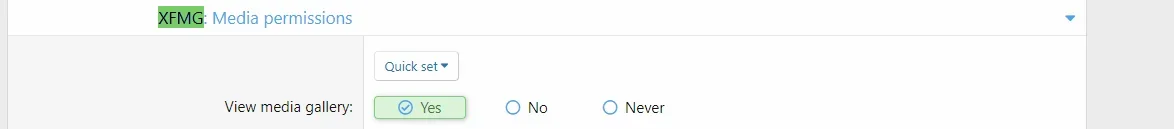

Well going in permission

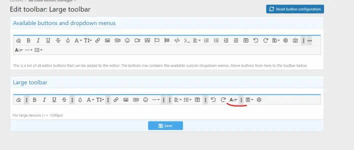

3) Add in editor:

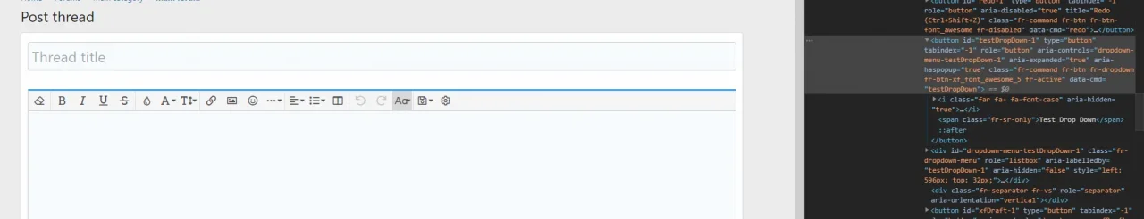

4) going in public part:
5) Trying give permission to view media
6) Check in public part
And it's work correctly and we can use dropdown menu. And the dropdown is not hiding
