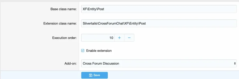

Make sure you've created the class extension for the posts class in the control panel.
Do you mean add the class extensions for the entity to point at my entity extension as below
Ok so I have the entity in the sub-directory already but its named with the addon ID instead of the posts currently its called
"CrossForumChat" and the table name is xf_stcc_posts
I will chnage the name now and namespace to be StccPosts and start on the rest
What you name it isn't especially important, but the file location, namespace, class name, and short-name all must match up accordingly.
Yes.
Yes.
