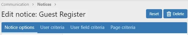

It is now possible to reset a notice for members using the "Reset" button, but it will still not reset the notice for guests. For guests you would need to recreate a completely new notice, which in my opinion makes the reset button not very useful in most circumstances.
Unfortunately, it doesn't look like this works for guests :(

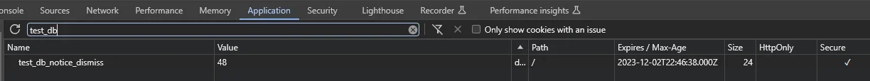

That's what I found as well. I haven't had time to look into it, but I'd be surprised if there wasn't a way to modify the expiration of the cookie. Since the cookie stores the notice ID as the value, it seems like it'd be possible to even set different expiration lengths for different notices.
