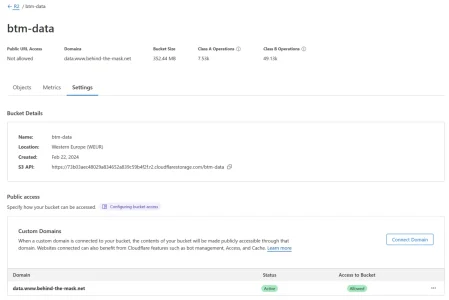

I would need to path of the files in Cloudflare R2.
Normally the paths are wrong as I did the same thing. If you view my replies and @digitalpoint reply to me you will see it is usually the cli.

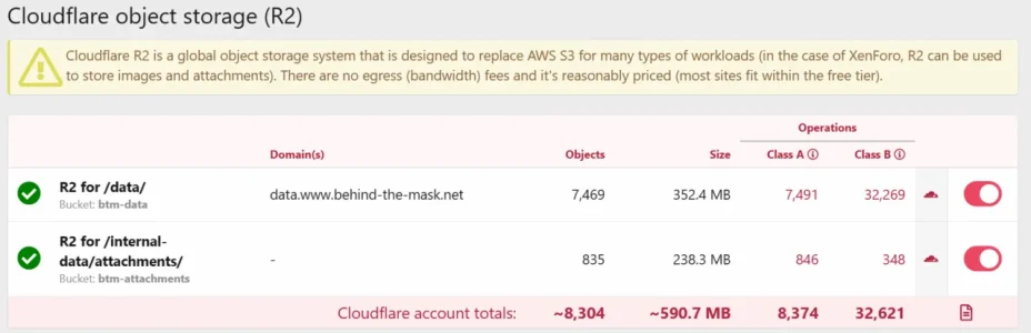

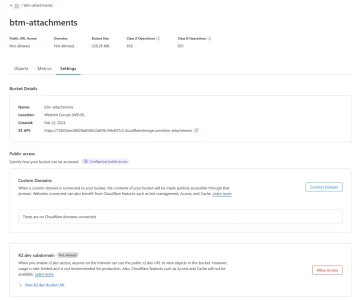

So, this is the screenshot from the r2 interface in acp -
I set up a data bucket, and attachment bucket. I added the buckets then to the r2 interface within acp, and selected the correct buckets for each one. I used standard settings to set it up automatically.
As far as I know, I don't need to do any further customiseation/changes on cloudflares end?

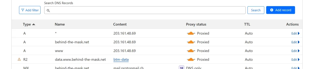

Viewing my DNS records, an entry appears to have been added -
The warning next to R2 just states that it's not covered by a cert.

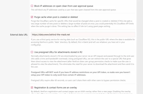

Settings in first page of addon -
Looks fine to me. And no, you don't need to do anything extra on Cloudflare's side.
I'm not sure what that is... Are you using a custom certificate for your zone? If so, maybe you need to update your SSL cert to include that subdomain? I double checked my zones and they don't have that warning on the R2 DNS entries, but I also use the automatic Cloudflare SSL certs (I don't use the Advanced Certificate options).

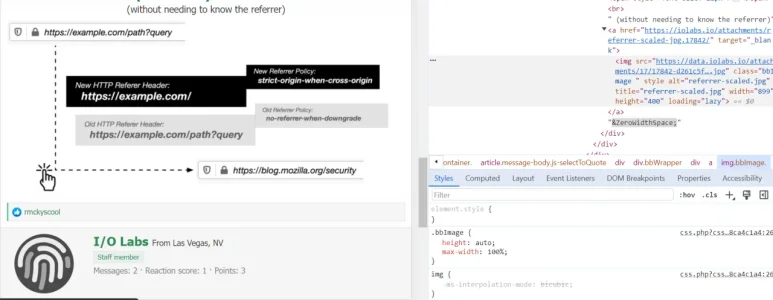

Why does his have the regular URL for his attachments but your attachments have the data. domain
When viewing my site/forum, an attachment url (after right clicking an image) appears as - https://www.behind-the-mask.net/attachments/1684330944127-png.1055/
That's normal... the application (XenForo) fetches content that are within the internal-data abstracted file system and relays them since it needs to do permission checking for access to things inside internal-data (for example checking permissions to see if the user is allowed to view that particular attachment).
