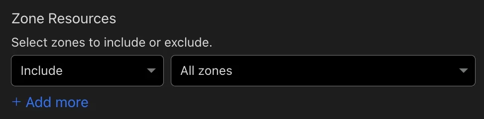

Changing Account Resources to a specific account does not change anything.
In Zone Resources I can enter a specific zone in the drop down and this saves. But when editing the drop down is empty.
I did not apply IP or date filters yet.
It looks okay there, but maybe set the Zone Resources to include "All zones" rather than a specific (but blank) zone? This is what mine looks like:
If that doesn't work, maybe somehow the token is mucked on Cloudflare's side? It wouldn't hurt to simply create a new token to see if somehow that fixes it: Create token
