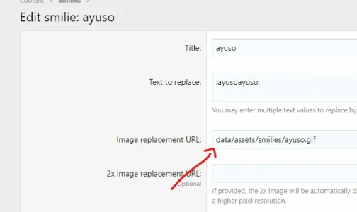

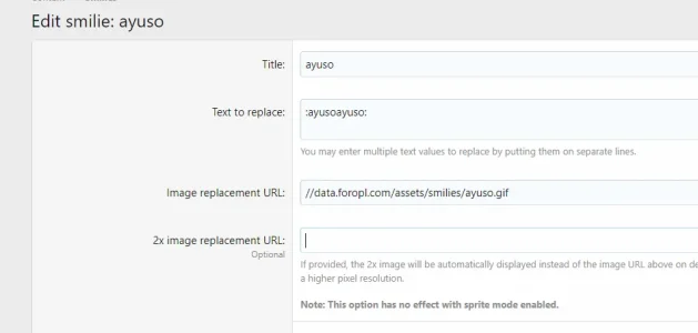

I found a bug with r2 storage, if i delete the local files from data folder after rclone move, all my old smilies uploaded by xenforo system gets a 404 error:
So I need to change manually to my r2 subdomain:
Same for pwa icons and so :D
