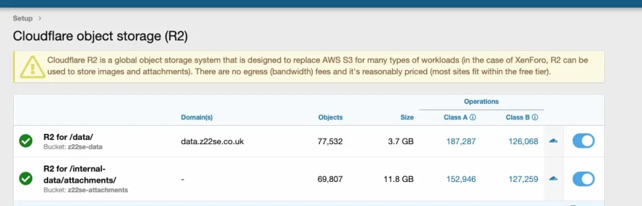

Should we add 2 different buckets?
For example, I created a bucket named "erdi". Do I need to create a data/ folder in it? Or is it necessary to move existing files to the bucket without creating the data/ folder?
I created a single bucket and created data and internal_data folders in it, it didn't work like this :(
The add-on uses 2 different buckets. A public one (for data) and a private one (for internal_data/attachments). You don't need to create a bucket manually (the add-on can do it for you). You also don't need to put anything in the bucket, certainly not a "folder" (there are no actual folders in a bucket, just objects with a unique name). Some interfaces will try to show virtual directories based on existing object names, but there's no actual folder anywhere.
Once you have a bucket (either one you made or the add-on made), you will want to move existing files to it (there's a CLI command to do it or plenty of utilities out there like rclone that will do it if you have a ton of data to move).
Again... forget about the concept of folders... buckets have no folders, so you don't need to worry about creating any.

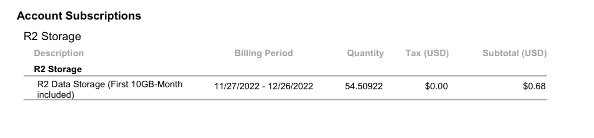

So ya, you use it for other stuff already... so that site will cost you $0.24/month (already used your free 10GB). Still not a bad price imo.
Yeah, I’ve been using it for 3 sites already. It’s not a bad price at all TBH.
Will be interesting to see how your class A/class B operations look going forward (they obviously are higher because of the process that moves all the new objects into them). I've done some optimization in the R2 adapter I made as well as with the cache rule you applied with the add-on, so operations going forward should be fairly minimal.
