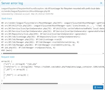

ErrorException: [E_WARNING] Undefined array key "cfMediaCachingSeconds" src/addons/DigitalPoint/Cloudflare/Listener/AppPubComplete.php:10
Generated by: Unknown account Apr 4, 2024 at 9:01 AM
so yeah, i understand that this addon is not yet updated to support 2.3 betas. just wanted to post this here. same issue on my test install.
Still not exactly clear why XenForo 2.3 wants to keep part of the data directory local instead of in the filesystem you want to use, but will figure that out (and possibly address if needed) later. For now, if someone is using XenForo 2.3, replace the addons/DigitalPoint/Cloudflare/XF/FsMounts.php file with this one and you should get the new local-data mount point that 2.3 uses.
