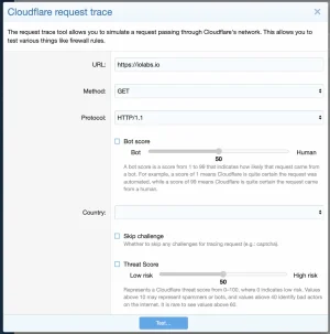

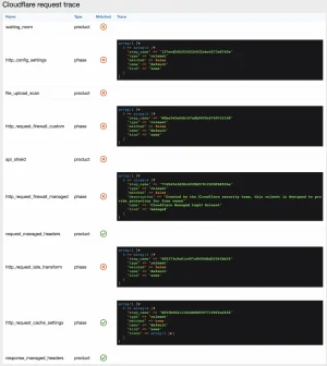

Working on a tool that allows you to do a simulated request and trace it as it passes through different Cloudflare products and phases. Allows you to see what exactly is configured in Cloudflare that could have blocked a request. Before I get too far along in it, I wanted to ask if this even makes sense to you guys...
You can see what product/phase matched the request and possibly took action on the request...

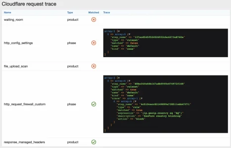

If I simulate the request coming from Antartica, I can see the request would have been blocked by the http_request_firewall_custom phase where I made a firewall rule to test things where I'm blocking traffic from Antartica.
Obviously it's more of a debugging tool than something you would use day to day, but as a debugging tool, does it make sense?

Could this possibly help fix my problem with cookies being broken? Not sure what's causing it since a friend runs a VPS and gave me free space on it, but they run Object Cache machine-wide.
Probably not unless you are doing something with the cookies at the network level (as they pass through Cloudflare). It's limited to things Cloudflare is doing (blocking or altering a request for example).
ah ok, yea, I'm not sure what's going on but my latest thread. Cookies and a "security error." are constantly popping up preventing people from logging in and registering:
Tried removing your cloudflare and security/passkey addons to see if that fixed it, no go.
