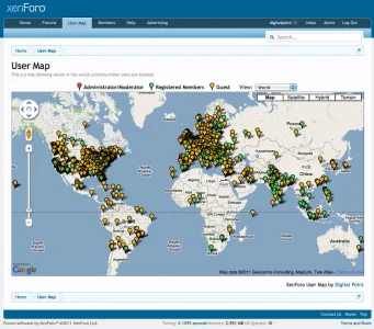

I ported one of my long-time vBulletin addons from 5 1/2 years ago to XenForo, so here it is...
About

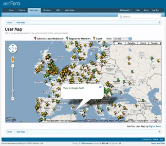

This is a system for geo-locating your currently online users and plotting them on a world Google Map. You can click any of the pins for a link to pull up the user's location in Google Earth.
This is something I originally made 5 1/2 years ago, and decided to port it to XenForo yesterday.

You can see a live version (although it's the vBulletin version) in action here:
http://forums.digitalpoint.com/usermap.php
