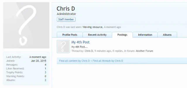

Imagine a newbie coming to a site where there is a forum, just like we have here (Off Topic and Test Messages) where posts are not counted. They will make posts and their post counts won't increase. Potentially confusing. Conversely, imagine having a private forum, a user has posted 4 messages, 3 of which in a private forum. Their post count increases, but when you search for the content, it's not there. Note my message count is 4, but only 1 result is returned.
