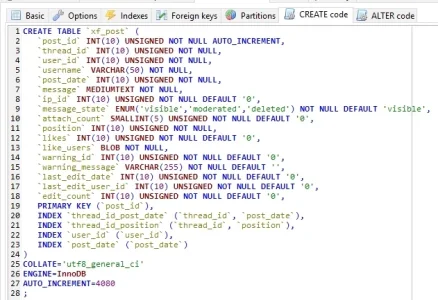

Here's what the xf_post table is

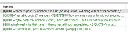

message is medium text which stores the BBCode text in post. So something like this,
If you are looking to import with DB inserts I would strongly advise against it. I have done imports from custom applications and obscure scripts for forums with millions of posts and millions of users and trust me it is much better to spend the time and write an importer in php which uses XenForo's DataWriters in importMode rather than directly in sql.
