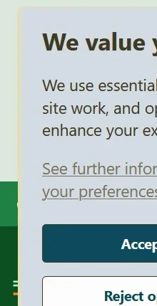

I also still seem to have a slight bit of the old cream colour round the edges - on the left particularly. As if the new colour is on top of the old one. Maybe to do with my style again?
Thank you so much. It looks so much better on desktop, when floating, and information is clearer to see. On mobile however, whether floating or not, it takes up about half the screen (not related to this addon, just the fact it's the advanced cookie banner) - which is horrible! I hate that on websites! I guess that's just the nature of a full cookie banner.
Btw it's still on the left :-) Not sure why but the extra.less code didn't move it to the right. Do you think that's possible?
