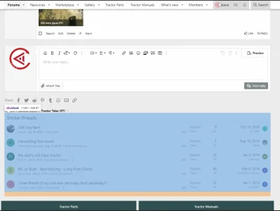

I am trying to move the breadcrumbs from the bottom of the page to move them above the "similar threads" container. It seems as though when I move them around within the page container they either move all the way to the top or all the way to the bottom.
My site is here:
MY SITE
as an example, here is a link to a thread:
EXAMPLE THREAD LINK
The request we have had from users is if we can move them up above the similar threads container.

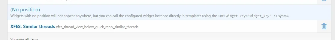

Maybe another way to work on it is to relocate the similar threads widget possibly into ad position container Breadcrumb (bottom) below

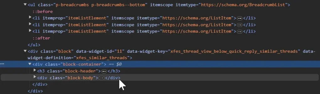

When I inspect the page (on my dev instance) I am able to move the Similar threads container below breadcrumbs and get the exact result i am looking for:
Here is the HTML:
My issue now is that I am struggling to find where that widget id 11 (the similar threads widget) is actually called and placed on the page. In page_container i do not see it called specifically and in the thread_view template I also cannot find it. Is there another template that I need to use to modify the location of that container?

First, reset all positions of the "Similar Threads" widget. So uncheck all position checkboxes.
Then find this code block in the PAGE_CONTAINER template:

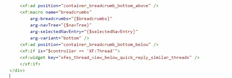

Under this code block, add the following code:
HTML:
<xf:if is="$controller == 'XF:Thread'">
    <xf:widget key="xfes_thread_view_below_quick_reply_similar_threads" />
</xf:if>
Let me know if there are any problems.
Sorry, I did not explain myself very well... Removing the widget location DID make a change that stopped the similar threads from displaying, but the addition of the widget key in the location you mentioned did not render it. should it be outside that breadcrumb div?
We reset the position so that the widget doesn't render twice, so it shouldn't appear at first, no problem there.
However, after adding the code, the widget should be displayed because I tested it in local XF and it works without any problem.
I appreciate your help. For some reason this widget is still not being displayed and I do not see any reference to it when I inspect element. Do I also need to reference this widget in the thread_view template or elsewhere to get this to render properly?
