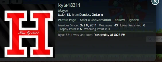

I would like to change its location instead of the bottom of the avatar (loads really slow as it's trying each username.) I would like to place it when you click on a username from the forum shows all the information of the user.
Picture for the example...
What would that post template be?

This is the template for the member card:
Admin CP -> Appearance -> Templates -> member_card
There are two hooks:
member_card_links
member_card_stats
But neither hook passes the user record. You will need to modify the template to pass that with the hook.
Cory_
OK, I didn't have any of these templates because I'm using a different theme.
member_card_links
member_card_stats
I do however; Have member_card template and apparent it does pass the user hook, so I implemented my code and worked successfully, just need to make it look pretty now.
