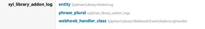

In the admin control panel under Development -> Content Type I added these values:
What these do are:
  • entity: adds entity definition for content type
  • webhook_handler_class: Register addon_log content type for webhooks
  • phrase_plural: adds a phrase to be used in the webhooks options
What these do are:
