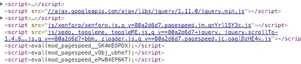

Hi! Hope this info helps to find the problem:Are you running a recent version of Apache, or an older one? More information on the HTTP server (version, etc) is always helpful as there may be a problem in the version you have installed.
Are you referring to the http://www.movilesdualsim.com/ site? If so, you left out one important factor. You are using PageSpeed. You will probably need to modify your PageSpeed rules if so. This could be likely what is effecting it.Any ideas from that?
Thanks Tracy Perry!Are you referring to the http://www.movilesdualsim.com/ site? If so, you left out one important factor. You are using PageSpeed. You will probably need to modify your PageSpeed rules if so. This could be likely what is effecting it.
