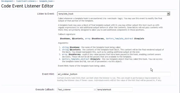

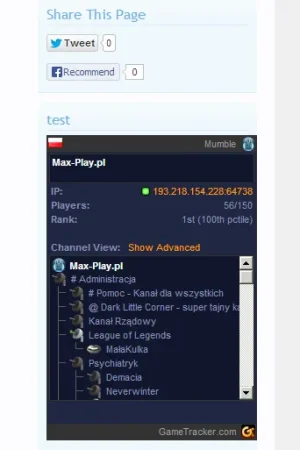

hm, working nice for me with the template code from
http://xenforo.com/community/threads/creating-an-addon-and-a-weird-thing-happens-help.53005/
PHP:
<?php
class Test_Listener{
    public static function templateHook($hookName, &$contents, array $hookParams, XenForo_Template_Abstract $template){
        if ($hookName == 'ad_sidebar_bottom'){
            $contents .= self::getTemplateCode();
    public static function getTemplateCode(){
$code = <<<C
<div class="section">
    <div class="secondaryContent">
        <h3>test</h3>
                      <iframe src="http://cache.www.gametracker.com/components/html0/?host=193.218.154.228:64738&bgColor=1F2642&fontColor=8790AE&titleBgColor=11172D&titleColor=FFFFFF&borderColor=333333&linkColor=FF9900&borderLinkColor=999999&showMap=0&currentPlayersHeight=160&showCurrPlayers=1&showTopPlayers=0&showBlogs=0&width=240" frameborder="0" scrolling="no" width="240" height="348"></iframe>
    </div>
</div>
C;
        return $code;

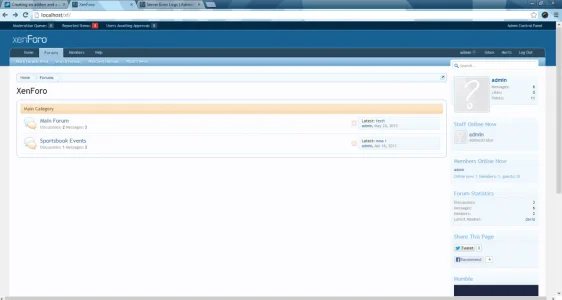

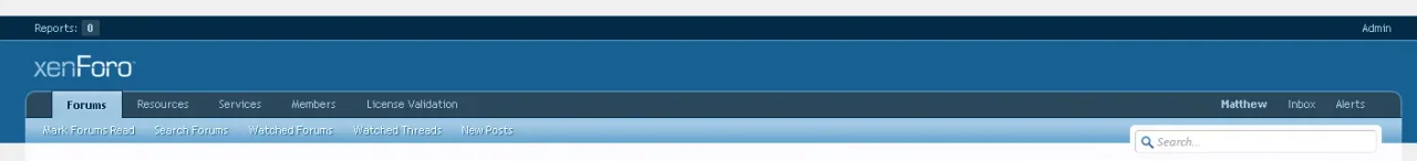

The sidebar isn't the problem. The problem is that theres a gray bar showing above the moderator bar

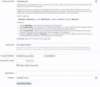

I tried this Listener.php. I deleted and created a new Code Event Listener and I got this error.
The server responded with an error. The error message is in the JavaScript console.

This and my original one both do the same thing. The template showing up in the sidebar IS NOT the problem. The problem is the gray bar showing up above the moderator bar.
I don't have a grey bar showing at the top, and I don't have a "Output already sent" error message.

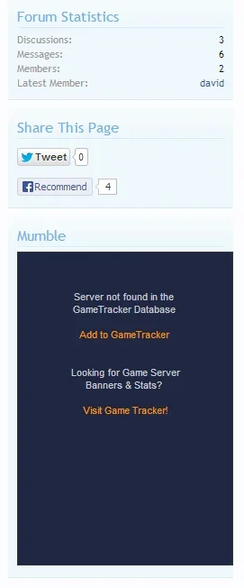

This is my local installation for xF 1.1.4. No gray bar at the top, and the mumble add-on partially shown in the sidebar, although game server can't be reached, but that should be an easy fix.
