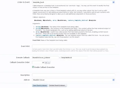

And this is what I put into the form for creating a Code Event Listener

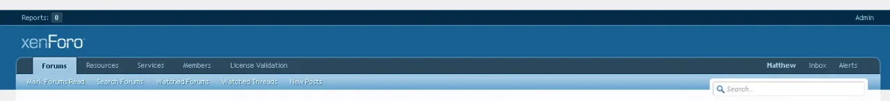

Now when I save everything shows up like its supposed to, except this happens. (You may have to look closely, theres a gray space above the moderator bar.
When I put "templateHook" into the Event Hint the problem in the image above goes way, but the template that goes in "ad_sidebar_bottom goes away aswell. I suspect there might be a new way of doing this in 1.2 or something. Anyone know the problem?
Thanks in advance!
the event hint for the templatehook is the hookname (did your read the description text? :D )
In your case => ad_sidebar_bottom

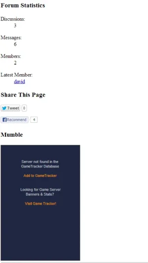

I tried it on my 1.1.4 test installation. It completely screwed up the default xf style, but I got the game tracker IFRAME to show up.
