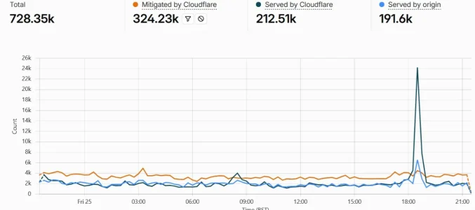

So my problem now is the rising CSR for my whats-new challenge rule - which is now over 30%. And this graph.
Usually the orange mitigated line is at the top - way higher. Numbers in the guest list aren't that high, but the fake robots are presumably scraping. Along with the 30% of bots that solve the challenges. I assume if I block the fake robots I'll get another swarm of global residential proxies.
So the CSR has slowly risen from 18% (where it had been steady for some time) to 30% plus over the past 2 or 3 days. And if it keeps increasing at this rate, the rule will catch very little.
So then where do you go? If bots can solve the cloudflare rule challenges? Bearing in mind these particular ones are using full/real browsers.
