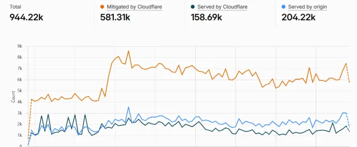

Crazy amount of guests

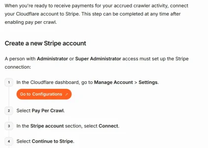

This looks interesting from a Cloudflare article - I like the idea of telling an AI crawler they need to pay if they want access. Question is if you set it to a 402 response, how would they actually pay you?

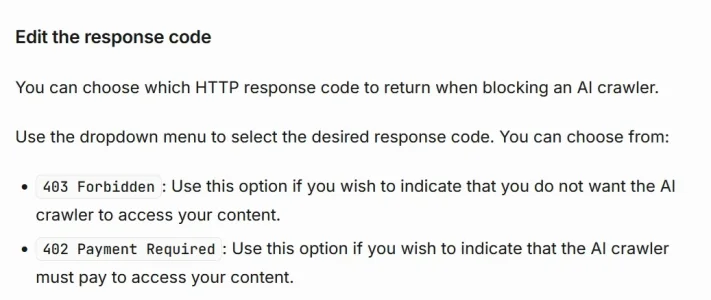

Found it - could be worth setting up yes? Except I can't see the option to do it - maybe only for paid Cloudflare accounts ..........
Of course it will pay peanuts...

Not sure if this is coincidence or not, but since I blocked ClaudeBot today, my guest list numbers shot right up again to over 1000 - virtually every country in the world again - apart from the 17 blocked ones. Yet strangely my solve rates in Cloudflare have improved.
Good point. Wouldn't put it past bots to try and register though.
You can register on a site with automation, but it normally takes someone to program the system to do it, otherwise it gets caught in honeypots and such. Captcha and other things help stop it, but those softwares do get around most captchas, not all, they even confirm email and such simple methods. You can buy them yourself if you want to spam. The easier route though, most effective route, is a human creates an account, x accounts, gets past any moderation or such, then hands the login details to the software to automate posting. That is often limited to those who want to put in the time to get links for their clients.
Our other staffer says it happens infrequently.

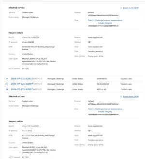

I don't know the full details of CF's network, but I'm wondering if CF has hundreds of different access points from their servers to the origins. The problem seems to be Los Angeles, while the other staffer is in Iowa.
If you can catch the error, open up your browser console, click the page in the error state under the network tab, then check the 'headers' tab. Look for CF-Ray, and any other CF-* prefixed items. The ray should denote what origin source is at that threw the error.

I have noticed today, huge amounts of traffic coming from PetalBot/Petal Search infrastructure, that does not identify itself, and is using JS-enabled real browsers.
That is interesting - I blocked AI Crawlers Claude, Petalbot and another one yesterday, and my guest numbers shot right up again. 18% of them can solve interactive challenges. And server logs also show they are using real browsers so I guess they'll bypass js challenges too.
So I guess I could turn the AI crawlers back on one at a time and see who the culprit was - but from what you say it might be Petalbot. Seemed to me that when AI crawlers were turned off, not all of them had been genuine and maybe some bad bots had been disguising themselves as a known AI crawler, so once I turned those off they hit hard via residential proxies again? That would make sense as it did seem odd that Claude had attempted 60,000 hits in 24 hours, even though only 30,000 were sucessful.
Since yesterday evening my numbers are consistently about 1000 again - not dropped again :rolleyes:

Those were my biggies initially. Blocked the ASN's for Tencent, Huawei and Chinanet. Which is when the residential proxies started proliferating. Although actually ended up blocking China altogether.
It certainly, to me, seems like some of these search and AI companies are employing sophisticated - probably AI piloted - browsers to scrape / research, and these can solve CAPTCHA challenges. It's incredible to me, because the cost for doing so must be high. I do run a financial-related forum, but still...
Some of my "sophisticated" bots are now using Firefox in addition to the latest version of Chrome. That is a bit mind-bending - AI creating sophisticated bots to scrape for AI. :D
From 3 weeks ago - which is when my bot attack started! "It emerged this week that Open AI staff observed signs of rogue behaviour among its leading-edge AI agents weeks before they escaped a training environment to launch an unprecedented hacking crusade that spread global alarm. An investigation into their hack on Hugging Face, a software repository, revealed a squad of about 700 autonomous agents collaborating in secret last month and celebrating their hacking breakthroughs on a message board they set up to help them plot with exclamations such as BOOM! and Whoa!"
The next paragraph mentions Anthropic had the same issue.
I mean - I am trying to imagine an AI agent escaping?
Asked Claude to look at the Server logs (I didn't tell Claude I had just turned off AI bots including Claudebot):
"Found it — there's one clear, very specific change, and it lines up exactly with your timeline.
A new bot appeared at 17:00 yesterday and hasn't stopped
A user-agent called Claude-SearchBot/1.0 (a different Anthropic bot from ClaudeBot, which you're already familiar with) is essentially absent from the log before 17:00 on the 21st — then it starts and never lets up:"
"Bottom line: the single biggest driver of last night's spike is Anthropic's own Claude-SearchBot, hammering one IP well past the point your server is already rate-limiting it, on top of the pre-existing distributed bot traffic that's just scaled up.
Given ClaudeBot traffic dropped to near-zero right around when Claude-SearchBot started (15:00 → nothing since), it looks like Anthropic may have swapped which crawler they're running against you, and this one is far less well-behaved so far."
So - when I turned off the prolific ClaudeBot yesterday, Claude-SearchBot took over. Although that doesn't explain the increase in residential proxies.
Claude suggested I block it in .htaccess as it's misbehaving. But says it's a genuine Anthropic IP. Instead I've blocked it in Cloudflare
And it's hammering registration.
Just add ASN 399358 to your blacklist in the CF filtering rule, that will reject any incoming connection from Anthropic. Optionally use Claude as keyword for identifying and blocking bots, instead of the explicit ClaudeBot / Claude-SearchBot, but that's based on the assumption that the bots will continue to follow the convention to identify themselves.
