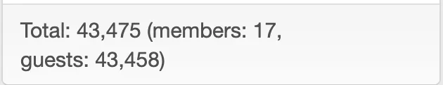

Crazy amount of guests

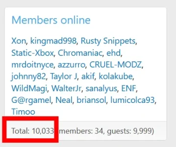

I have permanently between 500 - 10.000 senseless guests as well. But what are they doing?
As far as I see, they permanently go to index-page and slow my server dramatically.
