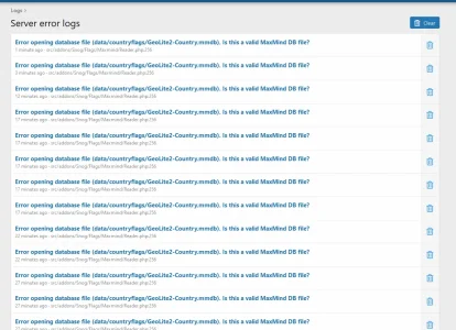

I have experienced issues with logging into my forum because there is something up with the addon, see attached (link to previous thread)
I would recommend that you disable all addons now.
Log into your forum's admin panel.
Enable all required addons except the add-on causing the errors.
This is until you get a solution from the add-on developer.
To disable all add-ons:
Edit your src/config.php file and add $config['enableListeners'] = false; That will disable all addons
I have not seen this before. Is this a fresh install or has this been running for awhile?
Can you post the stack trace and request state for the error? CP it here, don’t screenshot it. Thanks.
I'm going to jump in here. ;)
The file definitely exists on your system because the call to the reader does not take place if it doesn't exist. So if you're getting an error about the MaxMind database either the GeoLite2-Country.mmdb file is corrupted or if you recently upgraded your installation it could be very old and has never been updated for some reason.
You should be able to log into your admin account at yoursite.com/admin.php. Be sure the add-on is enabled and manually run the 'Update MaxMind GeoIP database file' cron task in Tools->Cron entries. Then see if the problems continue.

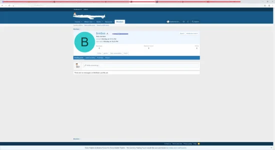

I note some member's I.D.'s do not show up a Flag, instead 'R' is in its place - please see the attached picture.
How come the Flags do not appear next to some i.d.'s? And what is 'R'?

The Reserved (R) flag comes up when the IP address for the user reports a reserved address outside of these IP's which return the Internal (i) flag:
10.x.x.x
172.16.x.x
192.168.x.x
The most common causes of that are either your server is returning it's own 127.0.0.x address as the user's IP address, or the user's IP address is being spoofed. You would need to establish which of those is happening (your host might be able to help), it's not something that can be corrected in the flags add-on.
So far as flags not appearing for some users, they most likely have not logged in since you installed the add-on. A user must log in at least once after the add-on is installed for their flag to appear.
