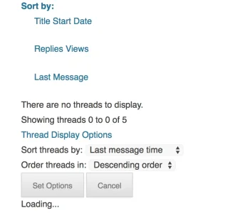

I'm close to rendering the thread list outside XenForo but know the params are not complete. I'd like to be able to set the node_id, number of threads to show, and see replies, etc.

The attached image shows what is rendered.
The struggle is figuring out the $params. Is there an "easy" way to figure these out?
If it isn't just the params, do you see something else needed?

Thank you @Nobita.Kun but I'm still not understanding how to get params. My code is returning the node_id for the forum threads to show. The print_r confirms this. However, the message "there are no threads to display" is showing as well as a "loading" message.
I agree that my code is not taking care of the html and css. I was going to work on that after figuring out why the threads are not showing. But, I'm not sure how to get the html div tag information to render ...
But first ... where are the threads? Why are they not returning? Is this because the params are not correct?

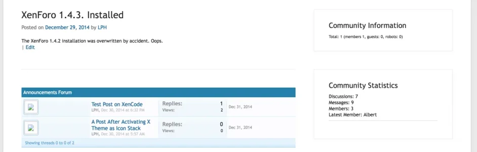

I'm getting close - but need to figure out a way to get the paths correct. This image shows a forum being displayed in a WordPress widget area, modifying the CSS of sectionHeaders to display:none.
The paths go to http://lph/threads/... instead of http://lph/community/threads/...
PHP:
$template= $dependencies->createTemplateObject( 'thread_list', $params );
echo $template->render();
