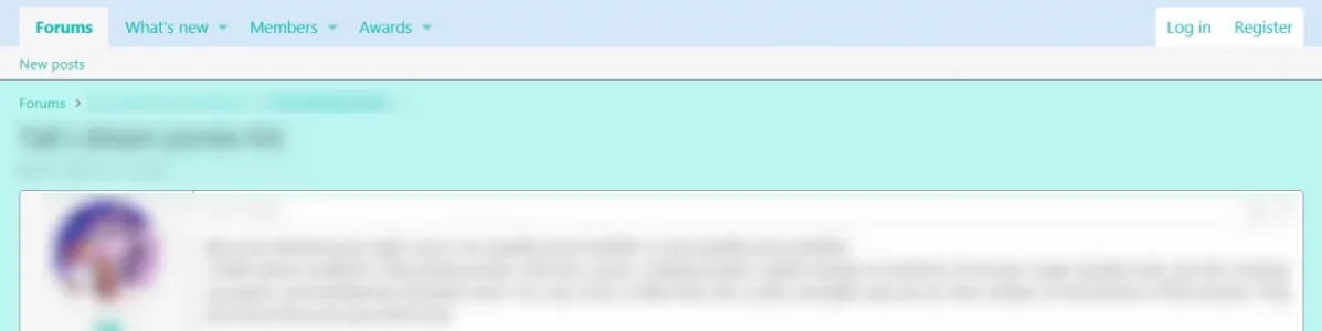

I have multiple members using multiple devices and browsers reporting that when they click a link from their email (like a reply notification) or a link within the forum itself to another place in the forum, they are logged out and told that cookies are required, but not given any options to confirm anything about cookies.
Our forum is really struggling with this, can anyone help?
Here is what happens when I click a link to a page within the forum, OR when I click a reply notification in my email. I am logged out, for one:

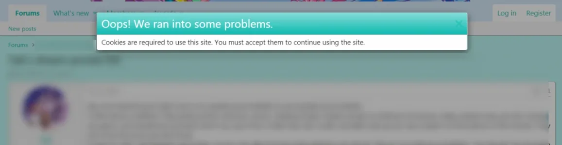

And this is what happens when I click "Log in":
