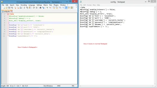

SOLVED
This is an odd one. One which has me puzzled and I don't know what is causing it.
But it's not a XenForo issue.
I've been using Notepad++ to edit my php files
@Paul M somewhere is going to preach how bad normal Notepad is and I recall he's the one who told me about Notepad++ It's never failed me before until now.
And what was happening is I'd remove that empty space seen in Notepad++ and it would end up merging the lines together.... Only it wouldn't look like that in Notepad++, but regular Notepad would reveal the truth.
As I hate Notepad ..... I guess its maybe time to find another editor (something free though).
But as stated... This not a XenForo issue.
