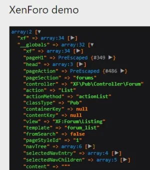

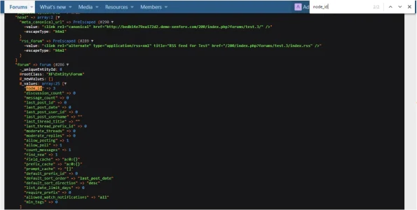

To add some context and to reiterate what I said in the ticket, you can check what params/variables are available in the template by adding this to the ad unit:
{{ dump(vars()) }}
Then searching for node_id on the page gives this:

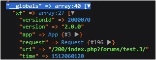

However, $forum is not available in that form but if you scroll up you can see it is within __globals:
So the full param is __globals.forum.node_id.
