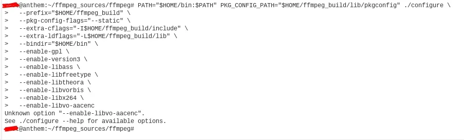

I think newer versions might have removed the libvoaac encoder.
Remove the last line and remove the back slash from the libx264 line.

Could you edit that out of the instructions or make an updated set, I just spent a lot of time trying to make that work thinking I was doing something wrong, as the page before i came to this post. the comments on the previous page implied it was necessary. I did learn a few things while trying to shove it in but I just wanna put a webm on my site and have spent 5 hours trying to install the required ffmpeg
and now I'm getting ERROR: libtheora libvorbis and libass not found What do i need for media gallery in 2019 ?

I'm waiting for this to finish running and then I need to figure out how much garbage I have left and tidy it up. I had got the libvo-aacenc installed it wouldn't configure.
I just added the --enable-version3 \ to the default instructions
