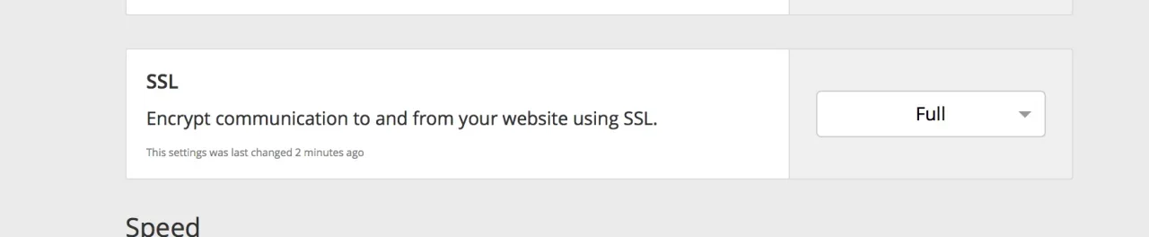

Ok, i have the SSL option enabled now..
I enabled a let's encrypt certificate for my domain, but If I try to go to https://mywebsite.com , I get a blank page.. I even changed the board URL, but it doesn't make any difference.
I would really appreciate any help to see if Im doing it wrong..

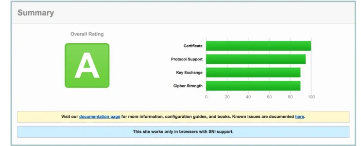

I checked the SSL certificate to see if its working using sslshopper.com, and the certificate seems to be working because I get all the check marks in green. I don't know what else I need to do at this point.

I tried to use the "flexible" SSL option, which means that I don't need to get my own certificate but it doesn't work, or at least I'm doing something wrong.
I checked the same lets encrypt certificate on my domain and I get an A.
I would appreciate your help guys... I really need some help.
