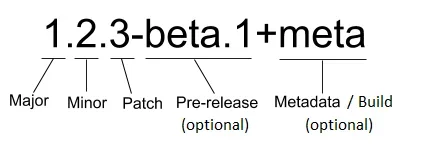

Until XenForo.com strictly enforces semantic versioning during resource submissions a "Check Add-on Update" resource will not be very useful and the amount of complaints and disgruntled users will be never ending.
If the Check Add-On Update resource misses just one or two resource updates out of a bunch it will still require the admin to go searching for updates and make them wonder how many others it may have missed, completely missing the point of the add-on to begin with.
XenForo.com must add a new "Semantic Version" option to its' resource submission form. This option must strictly enforce the semantic versioning specs. They are pretty simple to follow and anyone who has coded a resource should not have trouble figuring it out quickly.
Resource submitters can name the resource "version" anything they want but the actual "semantic version" submitted for the resource must follow the specs so a version checking add-on can work as well as it should.

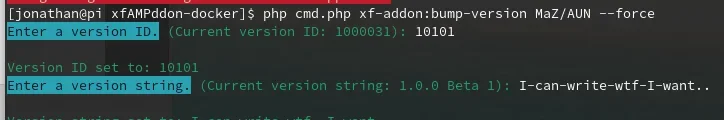

Yeah, this is honestly the "biggest problem"... The CLI command to bump versions is not really user-friendly and when you write a "wrong" number it allows the developer to also put whatever version string they want... (Contrary to popular belief, developers are also users/human) :D
If you do it correctly XF handles it magically:
But if I write a number that is not within 1000000 and 99999999
This is bad because it allows the addon devs to manually write something that doesn't match the number... Instead, it should enforce the "standard way" by default, and if some addons dev doesn't like that they should explicitly have to circumvent it by using a flag like --non-standard-version so that we really "force" devs to use the format that XF expects..

While XF does have some tooling around version handling; the CLI command xf-addon:bump-version is not terribly useful.
Run without a version argument, it prompts for a unformatted int based version_id which you need to manually build from from the add-on's existing version string just so it can attempt to build a version string for you. It doesn't actually bump the version either, and doesn't understand semantic versioning.
The version "1.2.3 patch 10" can't actually be encoded with CLI tool, and I've had legitimate reasons to need that.
