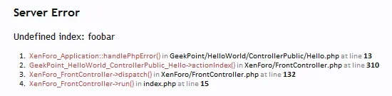

Okay so when you use the xenforo framework on your website for integration it will then also use xenforos error handling classes, which for me is becoming tiresome finding every little time i haven't fully set something.
As if you have an undefined index, the error reporting doesn't tell you, it just craps out with Xen's unexpected error message (even though the script would still run perfectly).
Is there a way to turn error reporting off, maybe passing something to a function?
Assuming you're talking about the "An unexpected error occurred. Please try again later." message; that would appear only if you don't have debug mode enabled. It's highly recommended that you enable the debug mode while you're developing your application. (and disable it before going live).
While in debug mode...
» From outside the MVC environment:
» From inside a controller:
