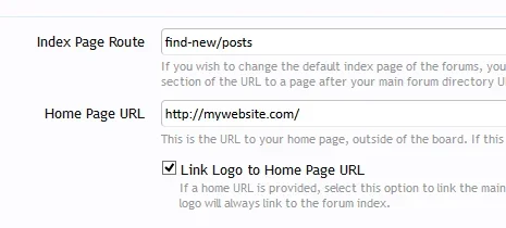

While waiting for a better solution I've set up the following in Basic Board Information:
Index Page Route : find-new/posts
Home Page URL : http://mywebsite/
Currently going to http://mywebsite/ or clicking the the Home menu item both redirects to
http://mywebsite/find-new/6867/posts (The number keeps changing from time to another). The URL in the web browser changes. (I wish it would still show http://mywebsite/ )
Clicking the Forums menu item will of course still show the list of all my forums.
I've also tried to set Index Page Route to "find-new/34/posts". It works somewhat better because the URL in the browser is not changed. I realize though that the number "34" should not be hard coded as it's dynamic and will not be correct.

farang
#10
Thanks @Maru and @Mr Lucky
As the first page visitors get when they go to your site?
Yes that's correct. When they type http://mywebsite/ in the adress bar in the browser I want the latest topics (or unread topics) to show up at once.
I've already done the changes and it kind of works but as a result of that I changed the index page route field, a redirect occurs. I'm really worried that my SEO ratings will "go south" now when i have a permanent redirect on my root page. I wish my XF forum could just serve the page without making a 303 redirection. If so I wouldn't have to worry about someone bookmarking the temporary dynamic URL generated. ...
Mr Lucky
#11
However, when you have find-new/posts in the index page route, then the home page URL should not include it, it would just be: yourforum.com - the find-new/posts link should not appear in the browser URL field. That's the whole point of a home page URL
farang
#12
Thanks.
You can see my settings in the first attached file.
After entering http://mywebsite.com/ in the browsers web adress field, it imediately changes to what is shown in the second image. It's true that the find-new/posts link doesn't appear in my browser. It's a different URL each time but I wish it would not change at all and remain http://mywebsite/ :D
