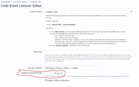

@x8BiTw0LFx How to change tabs order:
1- enable debug $config['debug'] = true;
2- go to yoursite.com/admin.php?code-event-listeners/
i will show a demo from other add-on
find:
Click navigation tabs and you will see...
changing these you can order tabs as you wish.
Have fun

All callback executions is set to 10, so if I want to change the order, what should I do?

The actual listener file will set the POSITION of where the tab is, so if its set to MIDDLE and you want it after MEMBERS, you are going to have to edit the listener file and change the position. Some addons actually have options to set the position of the tab, so you might want to check that first.
