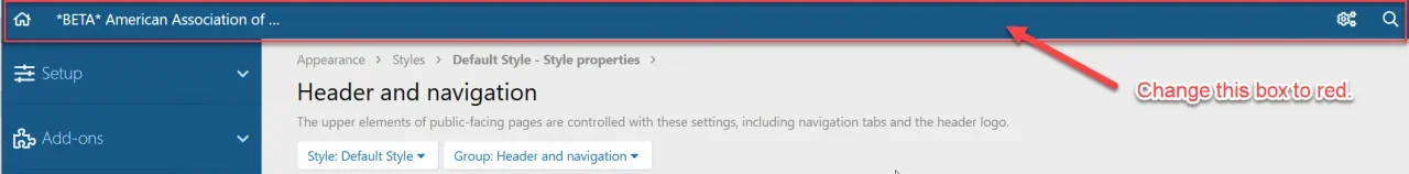

Question that is hopefully easy for someone here :) I run a test site of our production forums for me to test changes against and test upgrades before I roll it out to the main site. It is full copy of our main forums site, just dated by a few weeks to a month typically but it allows me to mess around with things and not break the production forums. On the test forums I have changed the logo header bar to red background from the normal blue we use so I do not accidentally make a change on production when I meant it for the beta test site. I typically have a lot of tabs open when I am working on the forums and the color change easily reminds me where I am at. I would like to do the same for ACP on the test site. I changed the name so it says Beta but I was hoping to change the blue there to red as well while not changing the rest of the forums theme. I searched and could not find anything on the support forums talking about this nor could I find it anything in the style properties. Any help is appreciated. thanks!!

All options list you can find in src/XF/App.php. Find $container['config.default'] substring, then you see all existing options where devs has default values.
Add this to the config.php file instead:
PHP:
$config['adminColorHueShift'] = 250;
It's hard to miss then ;)
This works just fine in XF 2.2.12. If you admin multiple forums this is a nice way to visually differentiate between them.
I went with a slightly less obnoxious color than Brogan's suggestion. ;)
PHP:
$config['adminColorHueShift'] = 340;
