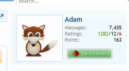

For now I've disabled mod expires (by design) to help with the cache issue. MaxCDN is doing all the caching.
For example, the avatar you quoted, I changed.... It shouldn't be a red fox. It should be a yin yang, but its still cached as the fox. It will not change until I flush the cache in MaxCDN
