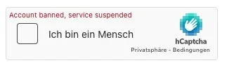

Just tried to register on my testforums and got this:
So it seems that hCaptcha has stopped the free service in the current form. Must have been very recently as I have been using it on my forums for new members and hat people register up until yesterday. I had even checked their homepage just recently as in the XF registration settings it reads:
No extra configuration is required for this CAPTCHA. But if you would like additional features, such as difficulty preferences and analytics, you should get your own API keys from https://www.hcaptcha.com/ and enter them below.
They still have a free tier after registration...
They still have a free tier after registration, however, the UX of their site is pretty horrible.
After registration you can generate a site key and secret, feed it into the XF ACP and it will work again. Seems they have stopped offering the service w/o registration/sitekey starting with Feb. 1st 2026 and - due to having no contact date from those using the service w/o sitekey/registration - they could not notify them proacively. At least this is my assumption asI could not find anything about that on their webpage.

You're not understanding the problem. If anyone is using hcaptcha without putting in any sort of API keys, the message shows that the "account banned, service suspended". It's not the forum account, it's the free version of hcaptcha without the API keys that is "banned" (from using hcaptcha)
You can still use hCaptcha for free, but you need to sign up and plugin the Site Key + Secret key.
