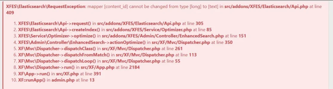

Suspecting that the index might be messed up, I wiped it and tried to rebuild, but got an error: "mapper [content_id] cannot be changed from type [long] to [text]" (see also pic below).

![1594118487372.webp 1594118487372.webp](https://xenforo.com/community/data/attachments/229/229699-c6111fc14ca63d83ebba99d2520a14d3.jpg?hash=xhEfwUymPY)
